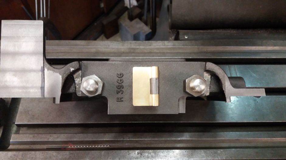

I have bought pattern letters from John Burn which were the cast lead ones. They are very good. The only problem is you have to buy each letter in a pack of ten which can get expensive depending how many you need.
For the most recent pattern I needed I used Plastic ones which are about 3/8 but other sizes are available.
They were from,
Slaters Plastikard Ltd http://www.slatersplastikard.com
I tried to upload a picture of them but image upload doesn't seem to be working for me at the moment.
This was the finished result. They are more than suitable for a small run of castings and cost very little.

Sorry, those ones shown on the casting are listed at 6mm high (but look bigger) Ref 1106
I still can't upload a picture of them for some reason, just goes to a blank page.
As a guide, the nut in the picture above is .820" across flats.
