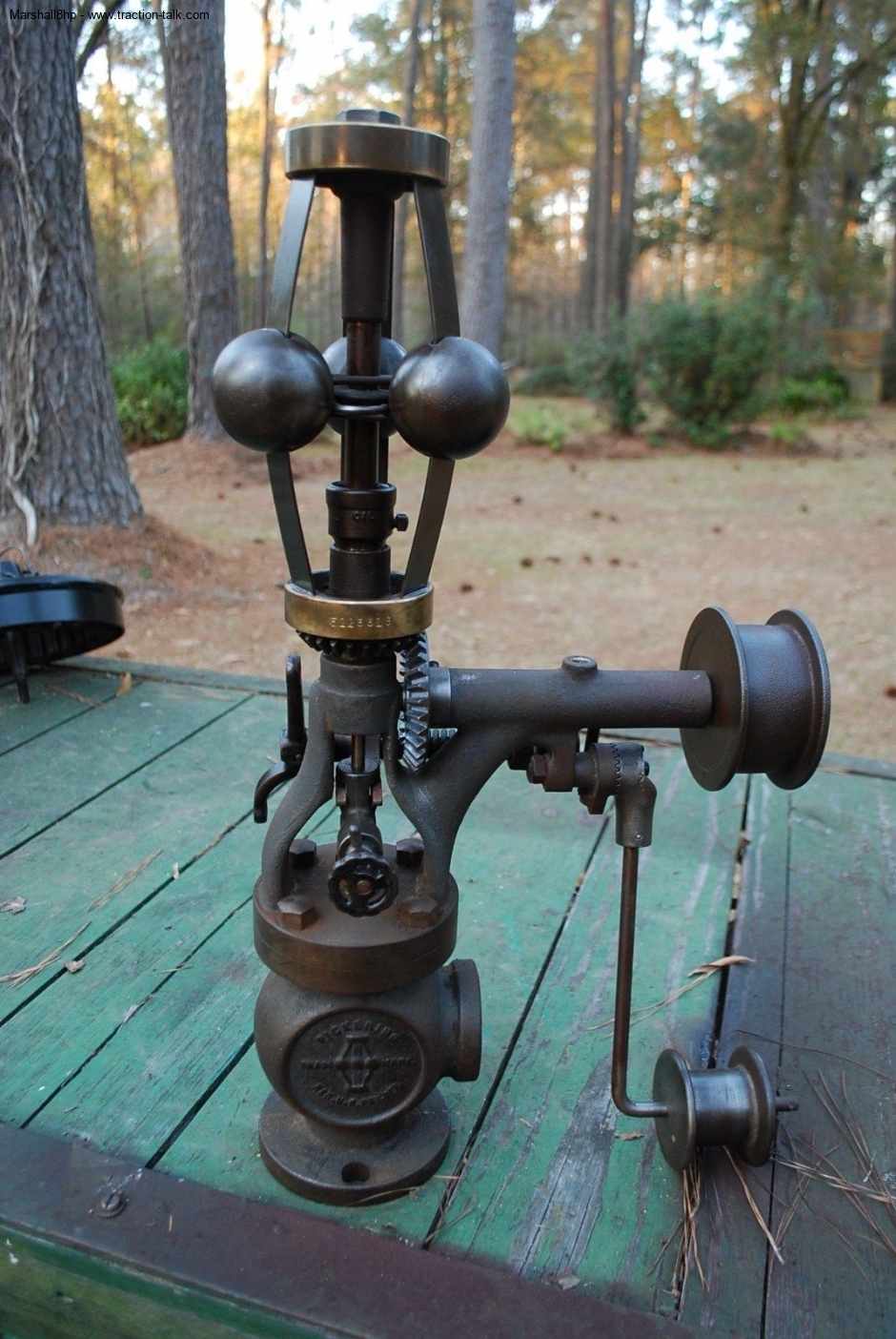

As noted above by Bob, this is a Pickering mill engine governor. the additional pulley rides on the belt, kept up by belt tension. It is fail safe in that if the belt breaks, the governor closes and cuts off the steam. In addition you will see it is fitted with a sawyers valve. This usually had a rope from each end to the saw (or machine) which allowed the operator to increase or decrease the governed speed at will, or effectively stop the engine.

Posts: 16,738
Also to be seen on traction engines . Burrell 1426 had the full kit , fitted later in life when the original governore were no doubt worn out . Recent owners of this engine threw it all out and fitted repro' original governors .

the governors on my Marshall has all the gear except the lever for the additional pulley.
None of it is original however. Not fitted with governors new.

Thanks for the interesting picture of a later Pickering governor with equipment to stop runaway in the event of loss of governor belt. I have learnt something today!
