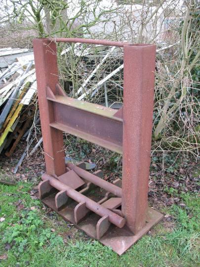

Old 29th December 2007, 05:55 PM
Posts: 15,184
Originally Posted by concorde View Post
I am looking at replacing the firebox in the above engine of 1926. Has anyone done it themself? How difficult is the making of a box, have you the formers to do so I could borrow, hire, buy?
A taster

Old 29th December 2007, 06:48 PM
Posts: 15,184
Crikey, what is that for?!
Bending the wrapper
Old 29th December 2007, 07:07 PM
concorde's Avatar
concorde concorde is offline
Full Name: Kevin Munn
Location: Middlesex UK
Posts: 332
Bending the wrapper
Mmm it will be interesting to see that done! Plenty of heat and weetabix!
Concorde
Old 29th December 2007, 07:13 PM
Posts: 15,184
I'm told, no heat, and a large jack
Old 29th December 2007, 08:15 PM
concorde's Avatar
Posts: 332
Okay but how? I can't quite see it myself

Old 13th January 2008, 08:42 PM
HerbaceousB HerbaceousB is offline
Full Name: Brian Rayner
Posts: 68
It can be done, I have shaped a 3' long 10mm thick section using a home-made frame and 4 x 20t jacks, cold of course. I'm pleased the frame didn't break, though!
