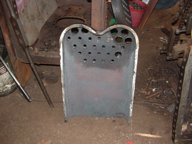

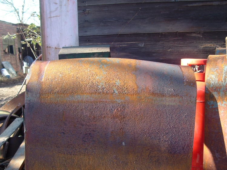

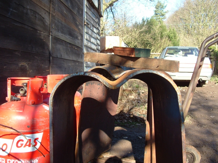

Just out of intrest who formed them? Look a nice job.
  #24  Post / In Thread
Old 22nd September 2010, 04:29 PM
Bosiboz's Avatar
Bosiboz Bosiboz is offline
Full Name: David Bosworth
Posts: 4,853
Stuart Woodbine of Chesterfield Derbyshire sadly no longer with us although his brother in law still continues the business I think.
  #25  Post / In Thread
Old 22nd September 2010, 05:48 PM
GRUFFER GRUFFER is offline
Full Name: steaming on
Join Date: Feb 2008
Location: Gloucestershire
Posts: 205
Andy melrose has also got a proper former for a garrett crown we mad it to do ours

A shame what will be such a nice engine to have a realy rough fire box should have talked to woodbines they do some cracking work.
  #28  Post / In Thread
Old 28th September 2010, 02:03 PM
boilerspecter boilerspecter is offline
Full Name: lew lewis
Posts: 162
if mr garnet is fitting the welded firebox and not the properly formed one, I am amazed, that firebox is tottally unacceptable . arwell it takes all sorts
  #29  Post / In Thread
Old 28th September 2010, 02:38 PM
Posts: 15,161
Hmm,
I have ofter wondered about these fireboxes after I learnt of the 4CD sold at Kivells had its example removed.
When you ask the right questions to the right people, it seems there are a number about so fitted. That is square corner welded Garrett style fireboxes without the front to back crown.
Avelings fitted similar fireboxes to the late type rollers they produced, and quite a few of these have been reboxed similarly.
As a engineer who deals with section properties of structural steelwork, strikes me that the form as in Mr Garnett's firebox is a pretty stiff structure. After all the crown's role is to transfer the force on the projected plan area of the firebox onto its side plates. I suspect that if someone were to spend a bit of time doing the sums it should all stack up.
