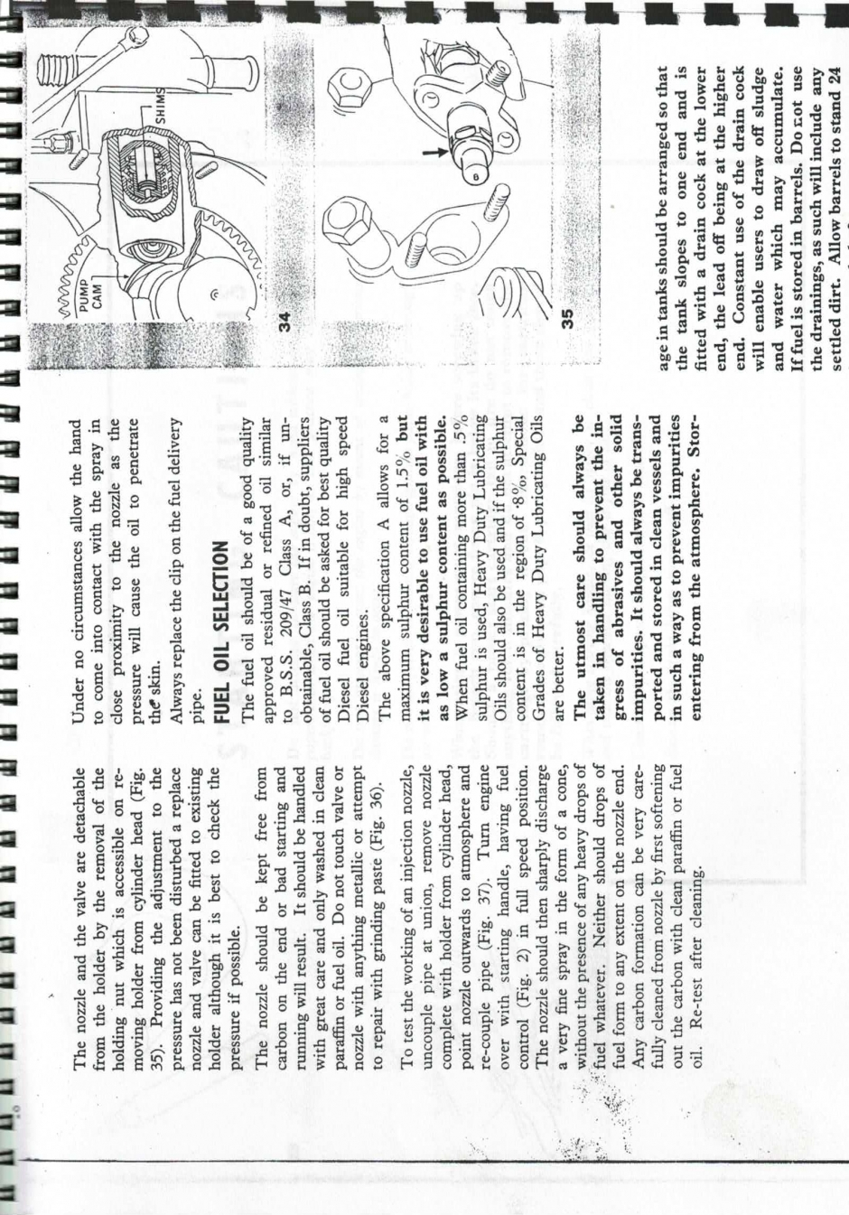

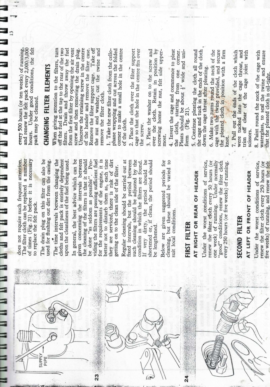

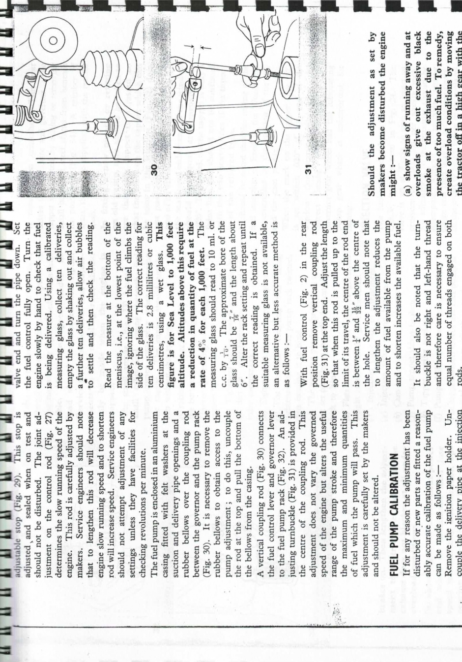

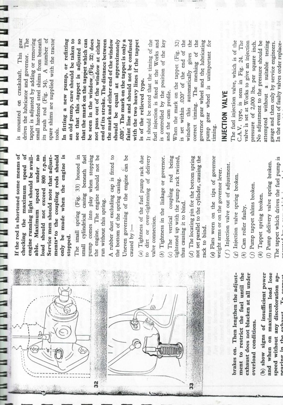

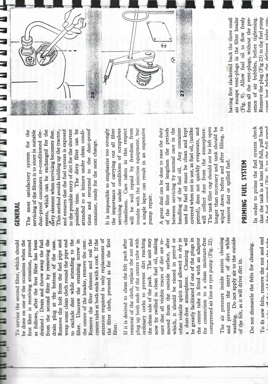

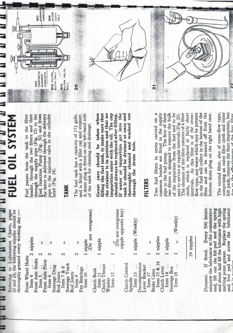

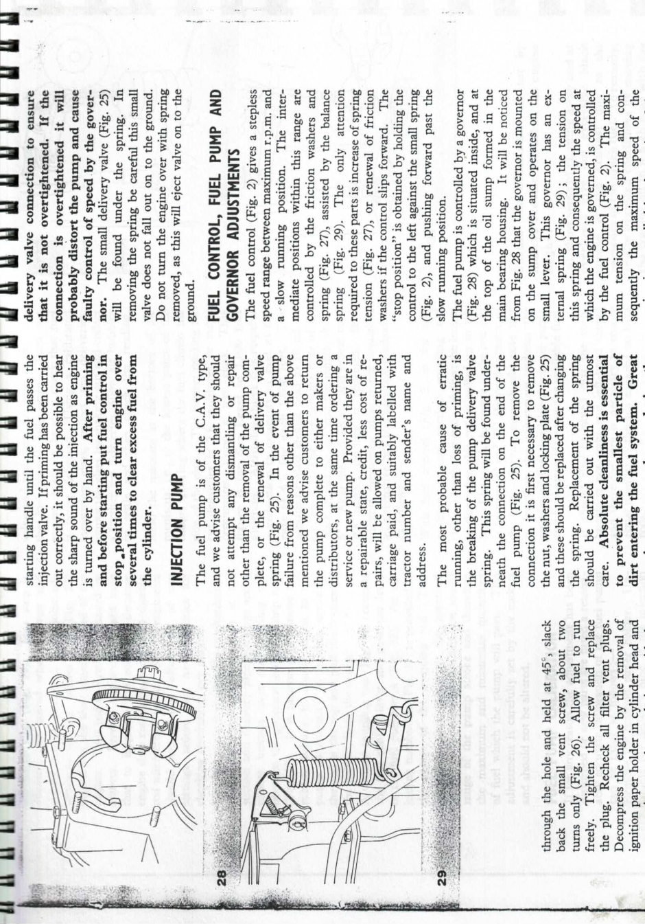

Hope this is of use:

Thank you very much for the replies! I have forwarded the manual scans to my friend and will post his progress here.
